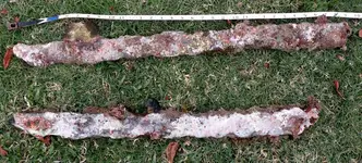

Here are two heavily encrusted sword blades, I have them in electrolisys now but the metal is wrought iron, and I doubt we will have much detail left when complete. Time will tell.

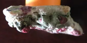

A piece of Chinese porcelein, very thin white porcelein. My hope is that there is enough pattern for someone to determine which dynasty it's from or something.

Could you give a closeup picture of the "porcelain? specially the break. Porcelain does not usually have the surface cracks. This looks like a glazed clay, not porcelain.
The "swords" are more likely barrel hoops or other flat stock.

Maybe I'm just confused on terminology, but all of the Kang Hsi dynasty "china" I saw from the 1715 fleet in Florida (I worked in the conservation lab with Bill Moore so I've seen quite a bit) had the cracks in the glaze just like this one. I posted a picture below of the break.
On the sword blades, I thought they were parts of barrel hoops or mast rings as well until I broke some encrustation off. You can clearly see the blade shape end-on and the grain in the oxidzed iron. I won't remove them from conservation right now for photos, but once a lot of the encrustation was removed, it's easy to see that they are indeed sword blades. Hopefully I'll find the handles in the next few days.

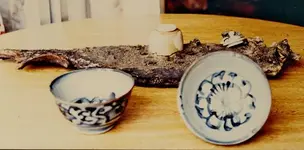

Attached a few pictures of Khang Hsi Porcelain for reference.

Nice china treasurediver! OK, so assuming these are glazed clay, what does that tell me. I've heard that copies from Mexico are generally made from terra cotta colored clay, these are white clay. I'm hoping some of these atifacts can give someone an idea of approxmate date and/or nationality, or even what port she might have hit along the way. I should have another set of divers on the site Tuesday, and maybe they'll find something more conclusive. Still awaiting word on the cannon, but I agree it's not from the same wreck. Any other thoughts anyone?

Hi Jason, I am sure the cannon belongs to the wreck if shallow most likely the rest were removed after the wreck or up until today or it only carried a small amount of cannon, the porcelain is 18th C it looks like it was made for trade or ship use, and maybe delft copy - this was mass produced up and until the 19th C - It could be of any nationality English, Dutch or Spanish or others, the blades alone without the handles are very unusual, very, they could be bayonett? Interesting wreck, too early to guess stay focused dont decide the cannon is from another site until you have more facts or you might waste time ,,,,,or not.

GFH - good advice, and I never make up mind completely until I have all the facts. Problem is, it's Semana Santa here (Dominican Easter) and nobody works, I got one dive on the site before things shut down...so I have nothing to do but ponder what it is and dream of getting back down there. :D The sword blades were ripped from the coral by local fishermen (hence only the blades, you can see the break points in the first picture), as was the cannon. All were sitting right next to each other completely encrusted, but not attached to the coral below. I can rock the cannon back and forth by the trunion...all three were moved there from somewhere else, without question.
