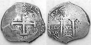

Sorry to say it doesnt look authentic. Its supposed to be a Pillars and Waves type cob but I see no waves.
What you have appears to be a replica made for fraudulent purposes. Actually its very ugly.Did you buy this in Nicaragua? Im going to save this in my database. It may be silver however. I dont know what the stamp in the center signifies. :icon_scratch: It should look something like this.

I circled some areas of concern. The waves on this cob are level. (straight across). Compare it to the CURVED waves of the one I pictured.. Look at the date above it. Look at the tops of the pillars. Its so worn its hard to tell but look at the lions and castles on the other side. This is not a replica, it appears to me to be a poorly made silver counterfeit. ...and I would not have bought it.

Here is an example of a silver counterfeit from the Central America/Mexico area. The deformed lettering is a tip off that I look for.
I looked with an open mind through my main reference sources, but couldn't find a match. I don't think it is authentic, but I won't call it fraudulent since I don't know what the maker intended or how the coin was represented in previous transactions. I agree with Don that the flat waves are not a dead giveaway. Flat waves seem to have been a more prevalent charecteristic of Lima strikes though. I don't know why the piece would have a reproduced counterstamp if it wasn't modern made. Could it be possible that the piece was a period forgery?
