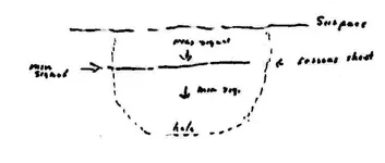

HI my friend: If you have encountered a very rusted flat sheet of iron, you will have the following typical reactions.

Pay attention!! I am going to tell you exactly what happened. I know because it cost me an hour of my time, but I found the target.
What you described is exactly what happens when you scan over a iron wagon wheel rim. You dug in the middle and there was nothing there. As you dug down, the signal deminished, but still pinpointed to the center of the rim.
Now go back there and dig on the edge of the target. you will find the rim!
This happened to me about 12 years ago, but you will never forget it.
You just gave up too soon. ;-)
