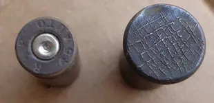

I found this shell casing in an area that had items dating from the 1850's forward. Thought nothing of it until I tried to decipher the headstamp when I got it home. Some kind of alien code?? :laughing7:
Included regular .45 casing to contrast.

Maybe im just lost, but no primer on that "casing" maybe not a shell casing at all? maybe a small cap to an old lipstick tube?
Looks to me like a rim fire that has been fired. The head stamp is weird though.
I do know it was fairly common that people would carve stuff into their bullets, not sure about the casings though, its a neat one though. I hope we get an answer on this one
I've never seen a shell with a base like that, it's not a stamp, it just looks like defects in the metal.... Can you get us a diameter in 100ths of an inch? And a length?
Maybe some type of metal match container? They put the texture on the cap so you know which side to pull off when it's dark?
Compared to the .45 ACP, it looks like about a .50 cal. There were a few different .50 cal rimfires that were made around the time of the Civil War, including the celebrated Spencer rifle.
Hard to say what's going on with that surface finish - but I'd say that was done after the cartridge was fired, unless the breech face of the rifle had some sort of pattern that was impressed into the thin brass of the cartridge. I'd say that was unlikely, given the low pressures that these cartridges operated at.
It's a large bore RF casing that was "played" with. It appears to be quite a common thing to do back in that era, when boredom set in around camp. Rimfire calibers up into the .50 caliber size were common in the 1860's...and many of those calibers were loaded for along time after they became considered obsolete because of the quantity of guns out there in working order. 44 Rimfire (think Henry rifle) was loaded all the way into the 1920's by the big manufacturer's...just a point made about dating locations where rimfires are found. That particular casing is too short to be a Spencer, I believe, but definately appears 50 cal. I will try and remember to dig out dimensions of the 2 different Spencer chamberings (both 50 cal, but different length casings if I recall correctly), and some of the other 50 calibers.
I observe here in AZ that I can rely on the casings to pretty accurately date campsites, based on the idea that this region was considered very hostile up into the early 1900's, so people armed themselves with the "latest and greatest." So if i find a bunch of large bore rimfires, I'm confident it dates to 1860's to early 1870's...when centerfire primers became more widespread. Even after "rimfire" died out in bigger calibers, "inside" priming and Benet priming confuses the issue on dates.
I have posted pics before of some unusual casings that were played with...smaller caliber casings pushed/pounded inside larger ones, and have found MANY 1860's era casings here in AZ that are cut into pieces, have holes drilled through, made into little "ornaments", even initials scratched on them.
If a match safe, maybe the head was scuffed up to strike a match on.
Looks roughly like a Spencer 56/56 rimfire case. But I'm at a loss for the markings.
Maybe someone reworked a fired case for a cane-tip or match case?
Length is approx 7/8 of an inch. Rim diameter approx .65 of an inch. Base diameter is about .55 of an inch.
Weird thing about the markings is that they are not scratched in but seem to be raised.
If the internal diameter at the throat is .55, I think it's not a cartridge at all, unless there is a .55 cal rimfire I've never heard of.... I'm leaning more toward lipstick tube top, which would explain the strange pattern on it.
The indentation on the rim from the firing pin is obvious....and consistent with identical casings I have...time to dig some things out and take pics/measurements for comparison.
Well, I looked and your measurements are pretty much right on for a 56-60 Spencer cartridge, I have no idea what's up with that base though, it just looks like some kind of defect in the metal.... You might send measurements and a pic to this site Headstamp Codes - International Ammunition Association and see if they know anything about it

Some of you right on, others didn't look good. It WAS FIRED in a Spencer gun indicated by the firing pin mark.
Could it have been FIRED in a Spencer Carbine?? Possibly...just like you can fire the shorter 38 special in the 357 mag, you could possibly fire this shorter cartridge in the longer chambered Spencer, if dimensionally similar enough. Ballard and Joslyn Carbines also were chambered in Spencer chamberings...and I bet other similar ones.
BUT...I do NOT believe it's a Spencer Cartridge......and if anyone is going by WIKIPEDIA dimensions for the 56-56....I consider them wrong, because the shown .875 case length is too short, this is per a long time collector that will forget more about this stuff than I will ever know, and my own research with this confusing cluster of similar large bore RF's.
