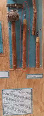

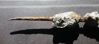

As an engraver you might like this find I made in the Ft Pierce area. The dune cut was nearly 8' high, and for some reason I decided to run my detector along the face. Bingo! My find is the rusty, crusty one of course. The other one is in a display at the McLarty Treasure Museum in Sebastian. They stated that they added the wooden handles to theirs, on mine you can see the remains of the encrusted handle.
Here is a comparison of the two tips. Look like the same smithy made both.
