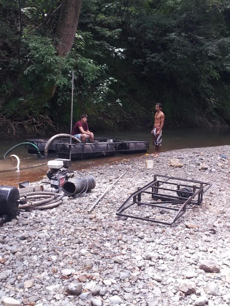

made it to the river Sunday for a little testing , change a lot of things and wanted to see if they worked right. had to wait 3 weeks for the rain to slow up and the river to go down.
got the dredge put together and ready to give it a try

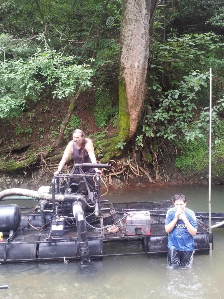

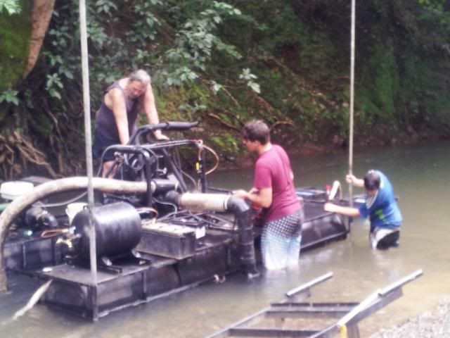

trying to find out why the pumps will not prime
no luck, had to pack the dredge into the trailer and bring it back to the shop. got the air compressor out and ran pressure thru all the lines for the prime , no air. started tearing lines off the find out why. i had left the lines unhooked for a couple of days while i bought and installed a couple new valves. damn mud wasp had built a nest in one of the lines. put a wire up the line and blew all the crap out, now works like a champ.

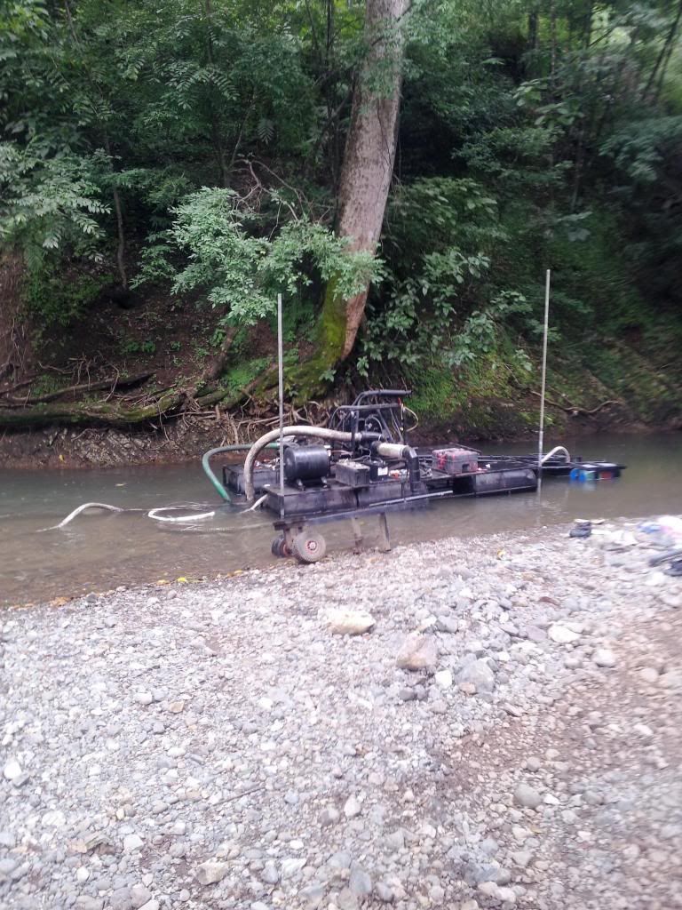

back to the river,

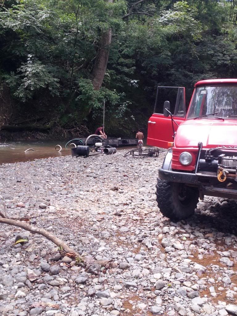

Bill, that is SWEET !@@! That your rig too, that is an awesome 4 wheeler. :thumbsup:
Wish I was doing all that.... still can't seem to get it out of mind.
Thanks, bud, made my day.
Oh and Hi, all!!!!!!
And ya never will CGDJ as it's in your blood man forever. Bill Unimog up and running bud??John
unimog is running great, it is a great 4x4 to get the dredge to the river.
