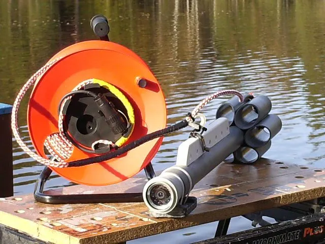

Hi Bum
Here my self-built tow camera, the ballast is now inside the fish.
It is a panasonic color camera with 40m cable and up to 30m pressure seal.
mvh
Rüdiger
