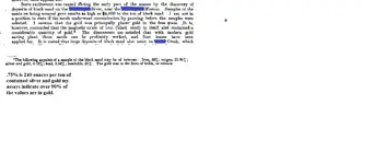

I wanted to post this extract from an old minister of mines report from Canada.It speaks to the possible values of Black Sands.I have had to edit the names of the creeks and rivers out because I am in the process of waiting for my own assays from samples I took there to come back. If they are any where close to this old reports statements I will be claiming what is surprisingly open to claim ground.
