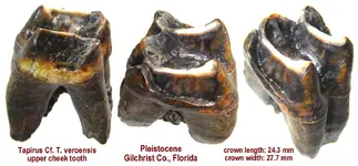

Show us your Pleistocene mammal teeth. Here's one:
tapir_upper_cheek.webp​

Here are three teeth. The top is deer, the middle is beaver, and the bottom is tapir.
Here is a close-up of the tapir crown.

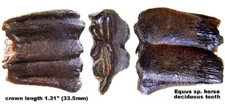

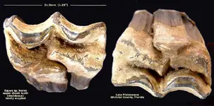

Interesting, Ninjafossils . . . allow me to add some information. You have half a tapir upper crown. Of the pair of "bison teeth," the nearer tooth is a deciduous Equus horse tooth. Of the pair of horse teeth, the one on the left is a nice upper cheek tooth, but I cannot tell what the right object may be. Here are some images which may help you catalog your collection:
