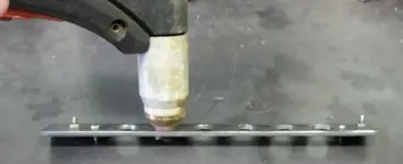

Initially I was going to suggest a template which allows the outer diameter with an offset to cut the inside diameter first.
70095d1258159826-straightened-renforced-added-toothbar-fel-plasma-circle-jig-test.jpg
But then I was thinking of the circle cutters for routers and torches and thought you could make a circle cutter out of a piece of strap and drill 2 holes for the outer/inner diameter and a small hole to rotate about the center.
You could get fancy with a magnet or clamp down plate for the center point
But I would just drill 1/4" hole for the center. Use a 1/4" bolt to hold the jig to the plate.
Then I would cut the outside diameter and STOP. Make sure it fits the trommel. You can adjust the outer diameter down with a grinder, using the same center hole to rotate the plate until the blank fits the trommel. Then go back and cut the less critical inner diameter. You can adjust it when the trommel is running.
