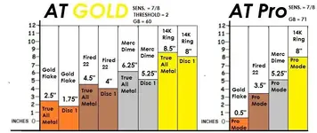

Garrett had this chart comparing the two detectors:
Below is a graph showing the differences in depth using the sniper coil during an air test. The AT Gold can not be used in salt water, as it can't be ground balanced to that degree. The AT Pro can be used in salt water.
Those depths are with the small 4 1/2 inch coil. The 5 x 8 double d coils goes quite a bit deeper. I have found coins at 12 inches with the AT Gold in wet sand. No, there is no ID number, just a tone. I also found a silver dime at 8-9 inches in moderate soil. I was in Disc 1 and it gave a high tone and 82 ID number.
That's a neat chart, it's nicely put together. Looks like the AT Gold edges out the Pro.
