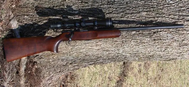

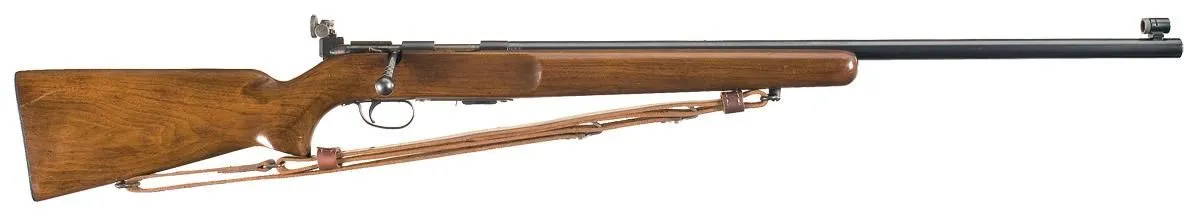

This 22 Remington started life as a 513-T target rifle. A 27" bull barrel and a heavy target stock .22 LR. They came out as training rifles for the military in 1942. After the war they were used by high schools and colleges for marksmanship training. As shooting in schools faded, they were available for cheap in the 60s-70s. This is what a new 513-T looked like.

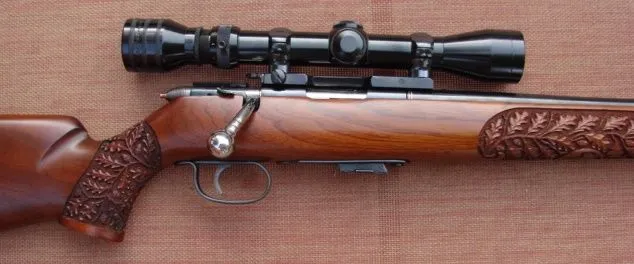

Since they were available cheap, some guys cut down the barrel and stock to use them for squirrel hunting I suppose. Bubba destroyed a nice rifle by doing this. And here is my bubba rifle.
Short, fat, and ugly. I bought if from an old WW2 vet that was state big bore rifle champ in the 60s. He gave me a good price on a M-70 and wanted me to buy this one too. I paid $250 for it, which I thought too much, but he was 95 and wanted rid of them so I helped him out. I went to work on it. I turned the barrel down to 5/8" and made a new stock. I tossed the scope and weaver mounts and found a vintage Redfield one piece base with a flip up peep sight. Redfield rings and a 2-7X Redfield scope with dot reticle took care of the scope. I drilled and tapped the barrel for another vintage item, a Williams ramp front sight with hood. I stained and finished the stock with poly and carved it. I think it came out pretty good. So good that I picked up another one and I'm just about to finish up number two.

Wow!
i was all set to ask how Bubba's rifle balanced , and where.
Suddenly it went Mannlicher , and some interesting knock an eye out oak carving!
Plus the barrel being turned.

thats a real nice piece of work my guy!!!! honestly, thats special, and would love to own that art work!!!

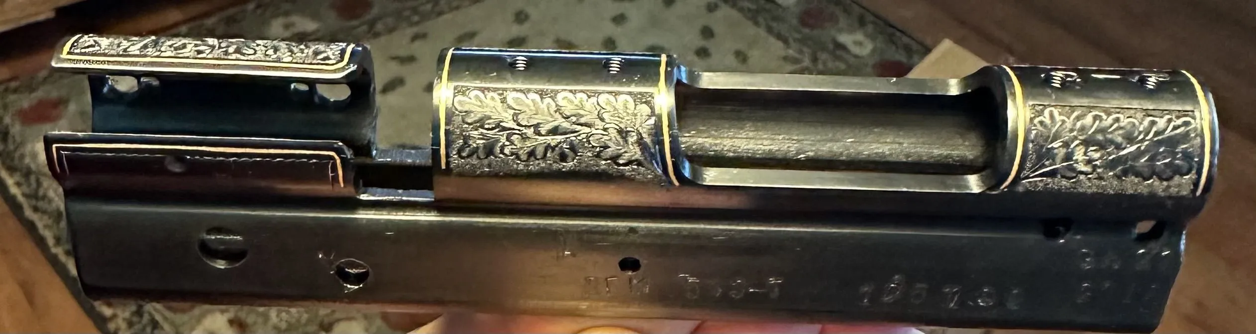

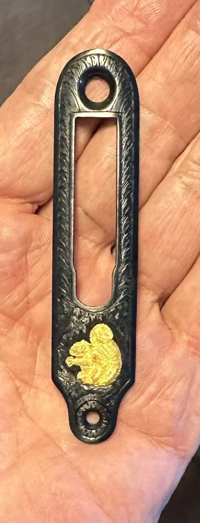

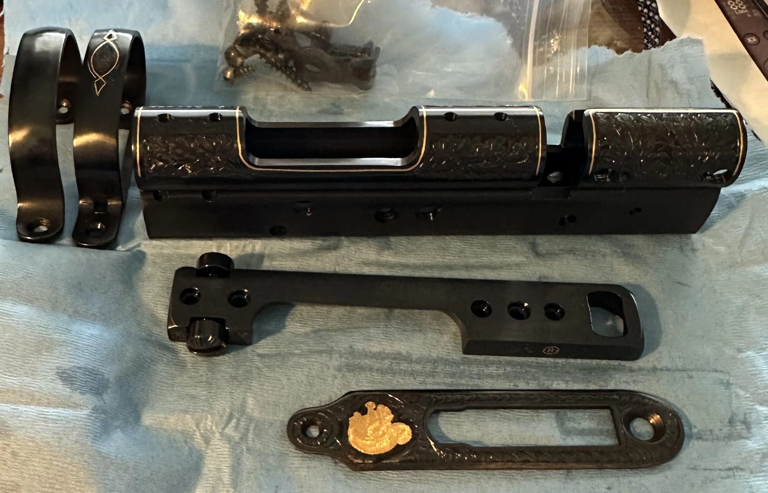

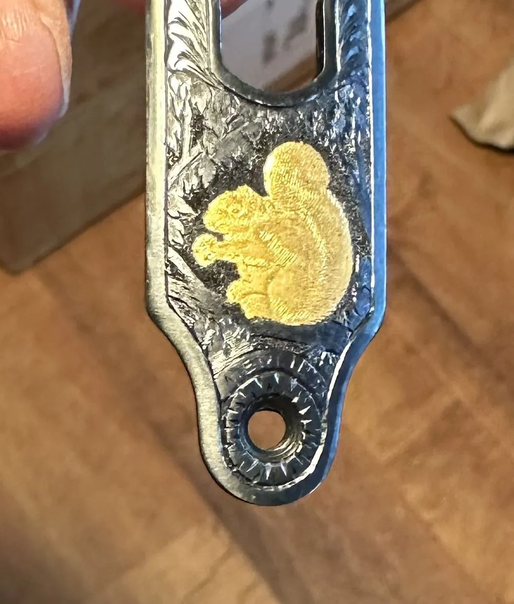

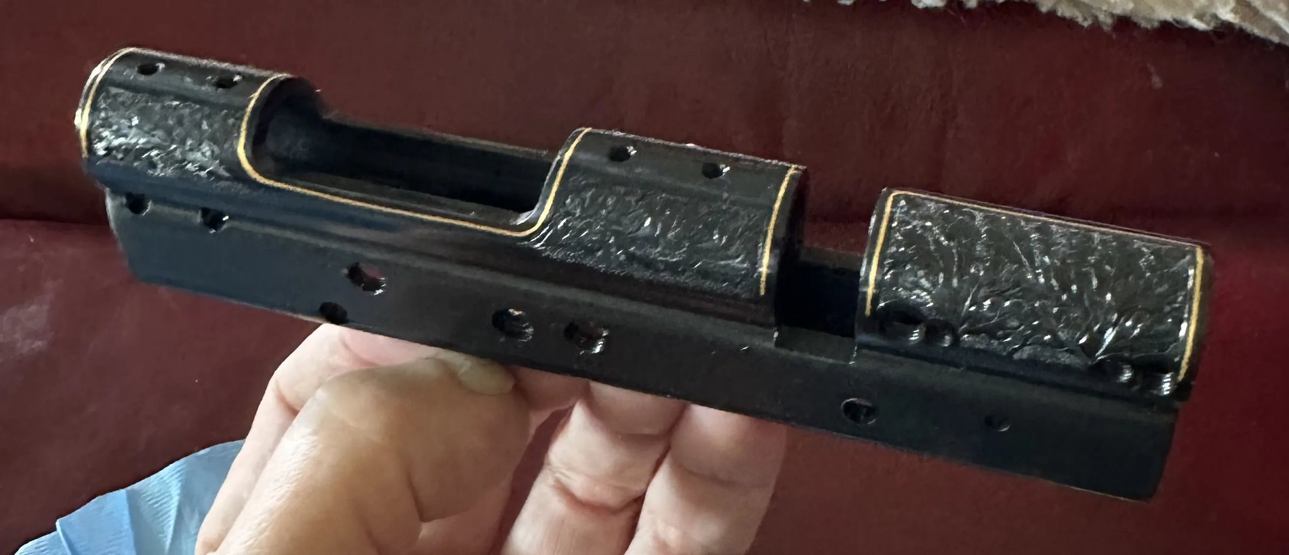

I’m updating this thread. I decided to put some engraving on one of my 513s. I just got the reblued parts back from Simmons in KS today. Now I need to swap a bunch of parts around and assemble the engraved gun with the carved stock. I’ll have a local gunsmith swap the parts. These are a bugger to work on. You about need three hands. I’ve got a missing thumb tip which really messes me up handling small parts. Here’s what I got today.
Gold inlays are difficult when it comes to pics. So much reflection.
I’ll post more pics when I get parts swapped and both of them reassembled.

Damn son, to say I'm impressed, would be the understatement of the century. I'm beyond envious of your skills.
Damn buddy.... I thought my dad was very good at building guns from scratch (he was) but I don't think he could even get in the starting blocks with you...! My dad could build black powder guns 100% from scratch and I always was so impressed.
You do great work guy.... good job...! :thumbsup:

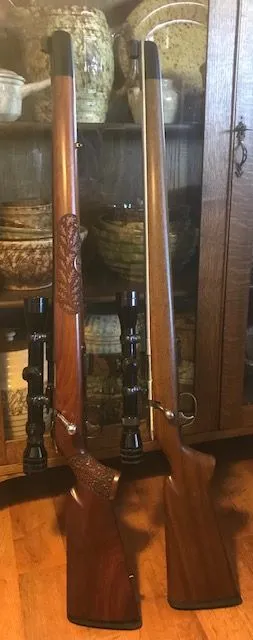

I made it down to the gunsmith and he reassembled both rifles.
Both of these rifles are the same model but made different yrs. I assumed they were identical. Wrong! The triggers were slightly different lengths and the shape of trigger guard slightly different. I engraved one trigger guard but it turned out to be the wrong one. So now I have a plain gun with an engraved guard and engraved gun with plain guard. 😩 I’ll have to go back and engrave the other guard. Another senior moment!
