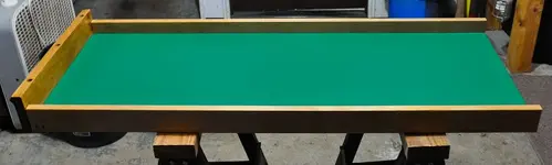

Got the basic table pieces all fit, drilled and test assembled tonight. Still need
to disassemble and then run a bead of silicone along all edges, then reassemble.
This way I'll have good water protection... not just at the inner edge, but
with the entire seam covered the water can't seep down into the seams.
Hoping this will stop any potential dry rotting (over the next decade)
when not in use.
The table itself is 15-1/2" wide x 43-1/2 long, so it should be able to work
with a decent amount of material at a time.

I'm very pleased with how the table top came out. Yes, I did sand the
initial coat, but followed that with 3 more unsanded coats. Worst case,
if I'm not happy with the performance I'll simply strip it down to bare wood
and start over with another brand of chalkboard paint.

Just finished putting it all back together with the silicone in the seams, and it
came out real nice. Should not have any leakage issues at all.
