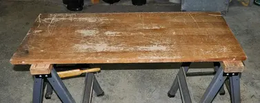

Made a diligent search for a suitable piece of slate or other appropriate stone material
(ie: affordable), but have decided instead to build using a solid wood top and numerous
coats of chalkboard paint.
Poking around my shop I came up with this old table leaf I'd shoved in the back of
my wood stack some years ago. We gave the table away to a young couple, but they
didn't take the extra leaf as there wasn't room in their dining area for the table to be
any larger than it was.
I checked it using a 5' level, and the surface is perfectly flat from end to end and
side to side.
Looks to be solid maple, with a thin layer of hardwood laminate covering the
top. I've since cut it to 16" wide, as there's an area notched along one edge that needed
to be removed, and a 16" width will work just fine. Next step is to sand all that old
stain off, and prepare it for a coat of sealer. (which I'm about done with as I write).
Finished table will be 15-7/8" wide by 43" long.
For a sealer coat I have a full can of Helmsman Spar Urethane, and plan to apply
several coats (to all sides/edges), with sanding between coats to insure a smooth surface.
Pics as it comes along, and as always, I'm completely open to helpful suggestions.
(Just don't get too far ahead of me..8-))

Checked the "local" billiard supply outfits (no manufacturers up here) and pretty much
struck out. One fellow had a piece large enough, but he also wanted a premium price
for it.
I simply don't have the funds to go buy an expensive piece of granite or other stone
material, and from what I've read using a properly prepared hardwood base plus several
coats of chalkboard paint will work very well.
Made the cut to 16" wide, and have completed hand sanding off the old finish. Used
150 grit to remove it, and now I'll give it some more sanding with some 280 and
then 400.
Q: When sanding off the finish I followed the grain direction, but would it be better
in creating minute striations horizontally if I did the rest of the sanding perpendicular
to the length?
I would use a jitter bug sander so there no scratches either the length of it,or the width.
They just vibrate back and forth.
That is what I am going toi use on mine I am building now.
Mine is going to be a little smaller though.

Neccessity is the Mother of Inventions...wood well sealed should work just fine...

Keep it as smooth as possible. You don't want the black sand getting hung up.

For flatness and dimensional stability, many DIYs use MDF for cnc router builds (checkout cnczone). As long as you seal the wood/woodlike materials well, it would make a great miller table base.

Have now sanded the table with 280 grit, and will start with the 400 tomorrow
or later this morning. When I'm completely satisfied that it's as smooth as glass
then the coats of sealer will go on. Can't seal it in this humidity!
Suggestion... instead of using varnish, try one layer of glass mat and epoxy all around and under. Will take a better beating than the varnish. TTC

Thought about that, as I do have some System 3 resin remaining from a driftboat
project I did about 10 years ago. I did a complete restoration on a vintage Don
Hill hull, and when it was done it was just too pretty for me to go bashing it down
the river. Sold it to a fellow who's still using it down in Oregon.
Gonna pass on the glass though. It's tougher, but 2 or 3 coats of this Spar Urethane
should do a good job, and I don't have to go through sanding down the glass. (appreciate
the thought, but I hate the stuff.)
