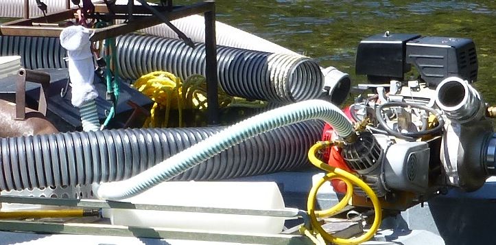

I actually have taken on using about 6' of 1.25" flex hose and relocate my air intake to the other side of the dredge.

Cool picture, ratled. Thanks for the info!
