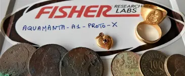

I test the latest Aquamanta Fisher electronic map
and I've never had anything so deep and sensitive about gold
not : the box on the video and the photos
just there / to test the cards
the final product will have a modern / lightweight design and well balance...
pre-series launch / if all goes well /
in the next three months
better than all my pulsepowers
and I owned 9 ....
some finds on my last tides
