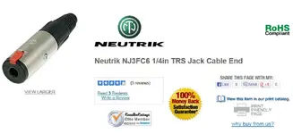

Be making these as soon as I find a decent 1/4 female jack
price will be around 22.oo plus shipping
Iam just going to cut my end of the stock Garrett's and solder on a female end and be done , a lot of money off eBay with shipping so I'll make it myself

I would rather go with OBN's setup.
I had that same issue...Lucklily I work for an Audio Visual company, and had one of the guys make me one.
will do Sandman, I just found some really good 1/4 jacks so I have to order them...
Did my conversion today , ran the wire through the handle and drilled a hole in the plastic end cap and screwed the jack into the plastic grommet, so now I just plug in my smaller headphones in the end and the way I go
Cost me $3.99 for the 1/8 female jack , I'll take some pictures later
