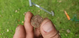

Glad you are back on track, Brian, and hope your neck feels better. Swing assist is a good idea and should help with back and arm issues too. HH.
Found this today so I am back on track :)
