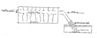

Good evening Beaks, You would ask sheesh: I have just spent 2 hrs going through boxes of old pictures without success. I did find three of the working area, but you can't see the retorts.
They were constructed of 3 10" x 10 ft. iron pipes with a door on the feed side, and a 45* elbow on the exit side which almost dipped into the recovery tank. The final connection was with canvas which when wet was impermeable. yet did not let any water return to the retort tubes. In effect they were just giant mercury retorts to collect Mercury from the ore which was walnut sized.
We had a local gal handle them. She was extremely careful and efficient.
Somewhere I have posted a story of sleeping by the retorts one night snicker.
Don Jose de La Mancha
p.s If I can find the other photos tomorrow, I will post them
p.p.s. My apologies to those that first viewed the pictures. For some reason they wouldn't size correctly.

my pipe runs from the iron cooking pot through an icewater bath and into the collector(dont have to worry about sucking water)
r.d.t.-i remember reading the story of you sleeping by the retorts :laughing7: ::) oink oink!
I ALWAYS wrap the discharge end of the retort thats underwater with a fine cotton cloth as the retort BUBBLES and the rising air also carries mercury vapors. Just a little extra caution to a many 100's of years old process. tons a au 2 u2 -John :thumbsup:

Hi my long time friend Hoser john: I suggest that you do NOT immerse the exit of your retort in the water. Under certain conditions the retort can suck water back into the system, then you have a minature atomic bomb on your hnds.
Please check on this as I want to have you as a friend for a long time to come.
