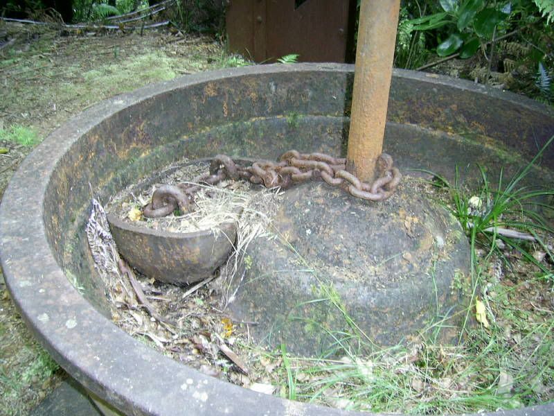

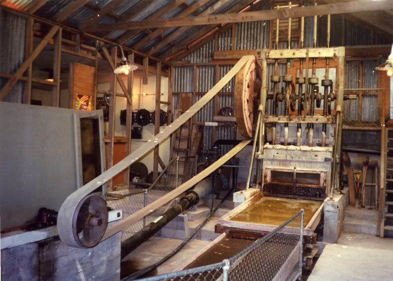

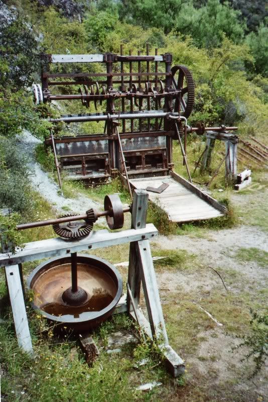

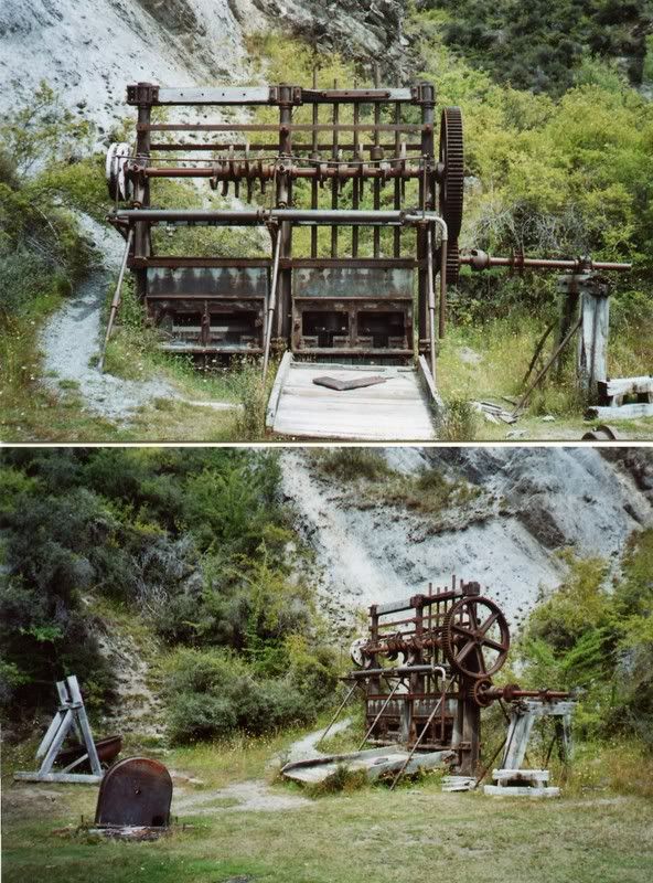

Hi guys, I have been a bit, lot, slack lately, Thanks Nuggy you answered that really well. Not much I can add to that except maybe a few pics to show an old derelict stamper set up that was powered by a pelton wheel, thing in the metal housing below the berdan, that drove the main cam shaft via a large belt from the pelton wheel on to a large steel fly wheel pully. On the other end of the main cam shaft was another pully, wooden, with a belt that went to the berdan, sitting in the wooden frame struture, to power & rotate it. Photo also shows the wooden table where the crushed ore passed over the table that would have had the mercury copper plates on it. From there fines where put into the berdan which as has been said had mercury in & was ground finer by a shoe or drag that was inside the berdan. Some times a large steel ball that would sit in the bottom end of the tilted bedan & just rotate & roll on the spot doing the grinding.
Here we have a berdan showing the shoe or drag sitting inside it
Here is a working example

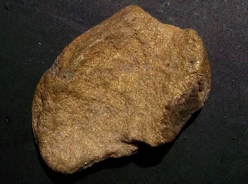

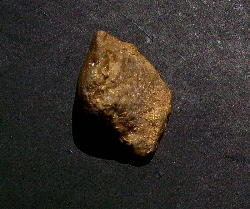

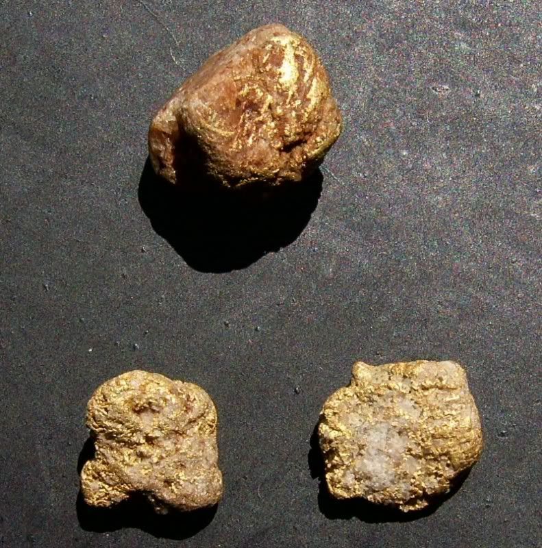

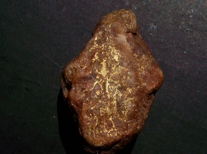

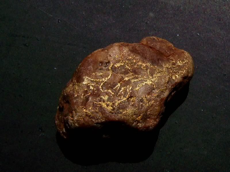

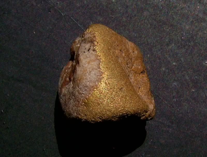

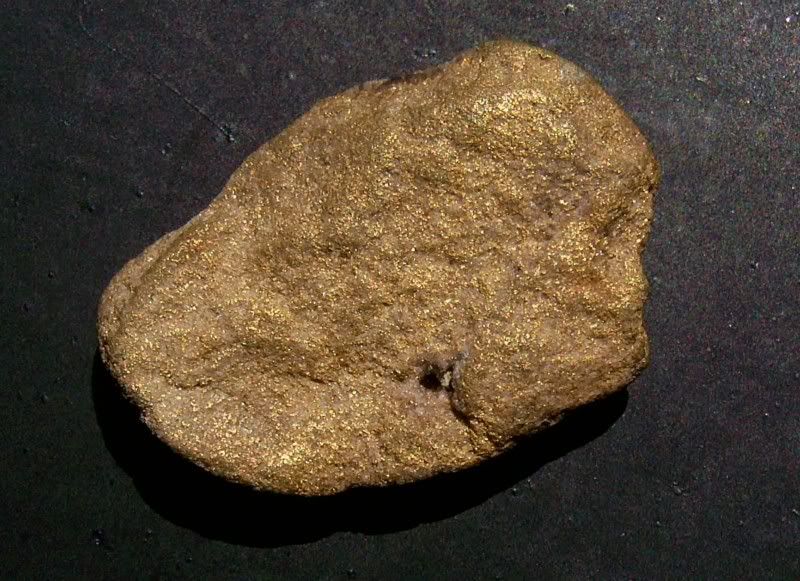

I havnt been out much since being back from the south island but I have had the dredge out a couple of times. Found 18 grams all up including the specimen bits. The big brown one to the right I found with my detector. The rest with my 4" dredge. Pretty ugly gold though. Very rough & not water worn. Hasnt traveled very far. Has a high silver content. The surrounding country is having the pine tree plantation cut down & when done will be good to go over the ground with the detector as in the early days a lot of rich specimen stone was found that lead the old timers to a few rich pockets of ore. There will have to be some specimens that they didnt find. So I cant wait until the forestry guys have been through. They are cutting roads in as I tap the keys.
Close up of the specimen found with the detector
Other speci's

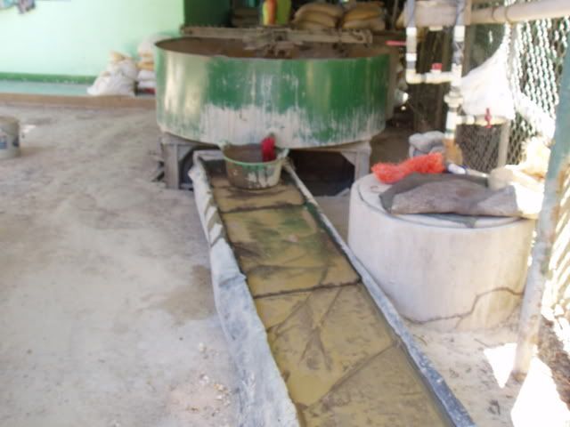

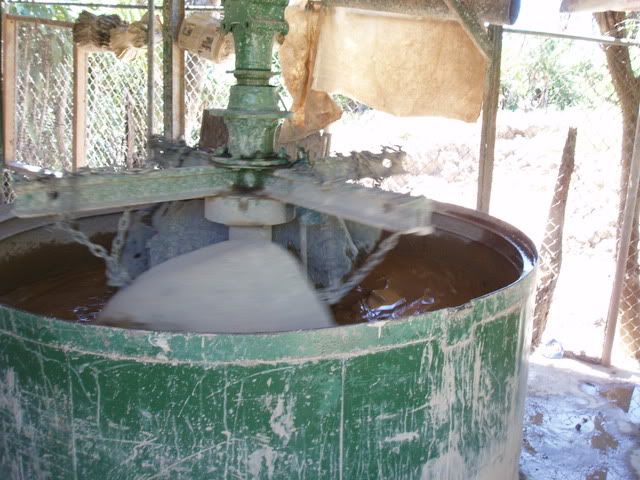

i look at the bergan and it reminds me of the electric arrastra they use here in costa rica for the grinding and recovery using mercury
an other one, these are spread all around the hard rock mining areas
