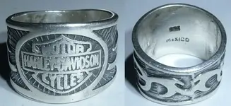

Here is one of my favorite ring finds ever, a small but very thick silver Harley Davidson silver ring.
In the ground it was bent in the middle into a figure 8 shape and had to be sitting in the dirt with the edge up, essentially it was seen by my detector as two large links in a small piece of broken chain and acted like another zincoln...and a bit bouncy one at that.
After straightening it out I tested it again and now it returned to a more normal signal between a dime and a quarter from all angles.
