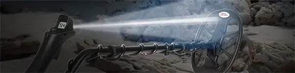

One is it has dual LCD display and one of the LCD meters is built into the shaft above the hand grip so you do not need to look at the LCD meter on the side of the controls. The meter stays off till you pass over a target then it displaces the reading, I had no problem seeing the LCD screen in the bright sunlight.
Next it has a built-in LED flashlight that shines on the coil when turned on, this is a nice feature if your hunting at night which many of us beach hunters do. Light is quite bright as well. Light switch is also built into the handgrip located just above the pinpoint trigger.
