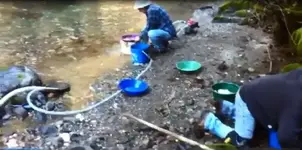

Don't quite have any picture that shows the layout of the land but can show you the areas around where we were working
Would be interested in checking the area underneath the roots, where the gravel bar hits the bank. Never dug all the way back, just worked the easy dirt first. Got to admit that I am totally preoccupied, thinking about next time.
