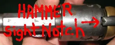

6 lands...........
6 grooves.......
mild clockwise twist.........
hammer notch that acts as the rear sight when the pistol is cocked?

Ok the 6 grooves is not what I expected so maybe the barrel is original.
I dont know if that is the same as the safety pin notch. My Italian replica has the same V notch. It is, like you say, for the sight. It should have a notch or hole that will fit over a safety pin (the way it was described).
