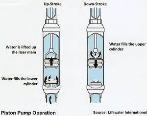

would something like this work?

i was outside working on a car. while looking at the engine something popped into my head. :icon_scratch: a strange idea i guess. would a piston driven pump work? i decided to come in for a break and draw this up.
kinda curious about it vs. a jet driven suction.

I have seen old engines used as water pumps externally powered.If the valves work...the pump works.
good idea

the only problem is sand is hell on seals. i suppose if you could work out a system to keep most dirt and sand away from said seals it would last a bit longer.
Yes it will work, and it is how alot of water at high pressure is moved.
Keep thinking though! You drew it out pretty well I thought!
I hope this doesn't date me, but I have had to work on a few windmills too( same thing)
You need check valves for the inlet and outlet sides.
The problem are the surges in pressure on the outflow side. No consistent outflow pressure which could stress the heck out of whatever is down stream on the outflow.

A lot of very good four cylinder Model A engines were ruined by making them into water pumps. The engine runs on three cylinders and pumps water with one. Some of those old farmers were ingenious making do with what they had.
From a pressure accumulator tank, then a regulator.
There are many configurations of "piston type" pumps. The basic hand bilge pump uses a piston with a flapper valve in it's head and a foot valve in the base of the cylinder. Frank...-
