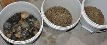

Snapped a couple shots while grabbing lunch..
The Dirt
GOT MUD??
From left to right: #2+ Mesh, #8+ Mesh and #20 Mesh+
Where it all happens. Stacked in the tub are 2, 8 and 20 mesh classifiers.
