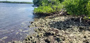

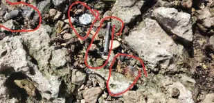

The box lay next to me in 4 ft while I fan tatgets....to rocky for a scoop here so its snorkel and fan.
Never met a spot I couldn't scoop... What kind of scoop do you have ?
Tin can with holes on a stick ?
:P
Coral rock with light sand over the top. All the heavy material settles in the swiss cheese bottom of rock that lies any where from lightly exposed to 2-3 feet under sand. Sometimes under the sand layer will be a pothole in the rock bottom that's jammed with shells and rocks that often have to be wiggled out one at a time to reach a target. I have left hopelessly deep targets that have been lodged in cracks and crevices in the bottom. 20190710_214116.webp all the bottom looks like this under the sand. If I'm lucky the sand is light and I only have to fan a little to get to the layer that looks like this, then its fan and pick the potholes clean of shells sand rock and targets. 20190704_161529.webp this was a sand beach with a foot or 2 of sand over it. It's been blown off by hurricane Irma. If you try to get down to the target with a scoop you will hit coral rock like this. In 4 feet of water here there's only a light layer of sand and a little grass here. coral fans and reef are growing on the exposed rock that sticks up out of the sand here. It will even look like a beautiful sand patch and then bang scoop hits rock that's still attached to the planet 4 inches under the sand !!
Perhaps a new scoop ?
