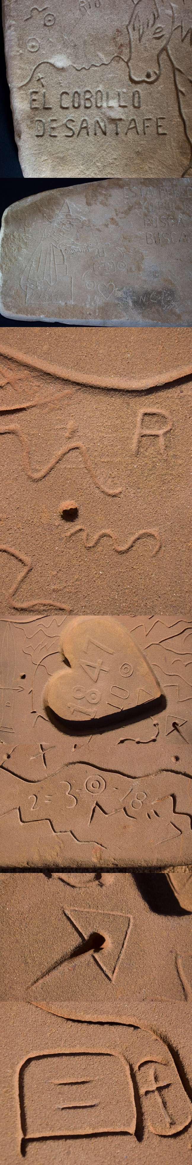

Okay,
So as not to hijack anybody else's thread with this very large picture montage, I have started this.
Background:
When Desert Archaeology Inc, examined the stone maps, one of the things they said they found in the resultant article in Arizona Highways Magazine was:
The use of an electric drill to create the drawings and symbols, as well as to create the shape of the stones, most likely dates their carving to sometime after 1940.
and in a subsequent email:
but in many places, there is a start dimple where the drill first touched the stone.
I can say that I have had just as close an examination of the stones as DAI, and I don't see what they are talking about. I have hundreds of hi resolution photographs of almost every detail, and I have yet to see any "start dimples". I also asked the nice folks at DAI just what would be the visible difference between an electric drill dimple and a hand drill dimple? No answer to this day (because there is no difference). I also asked them a simple question as to how a machine sanded surface would look different from a hand sanded one. Same result as my previous question.
While I don't see any "start dimples", I do see that most of the lines on the stones get shallower and shallower as they reach an endpoint. To me, it looks more like the lines were scratched into the surface with a knife blade or similar metal object. You can see in several places where the engraving tool came out of the groove and left a mark outside the line. Also in some spots, you can see where there two or three lines inside a single large groove. Does that sound like a drill or router? NO, it sounds more like someone going over and over the same groove with an engraving tool to widen and deepen it.
I don't question the examiners' credentials or their capabilities. I just needed some questions answered. If someone there had taken a moment to show me where I was mistaken, I would gladly have acknowledged their information and shared it. Remember, I don't REALLY have a horse in this race. I haven't spent a whole lot of time trying to work out the secrets of the stone maps. I live too far from the area to be of practical interest to me.
Here is a nice montage of some of the details of the stone maps to peruse:
Enjoy-Mike

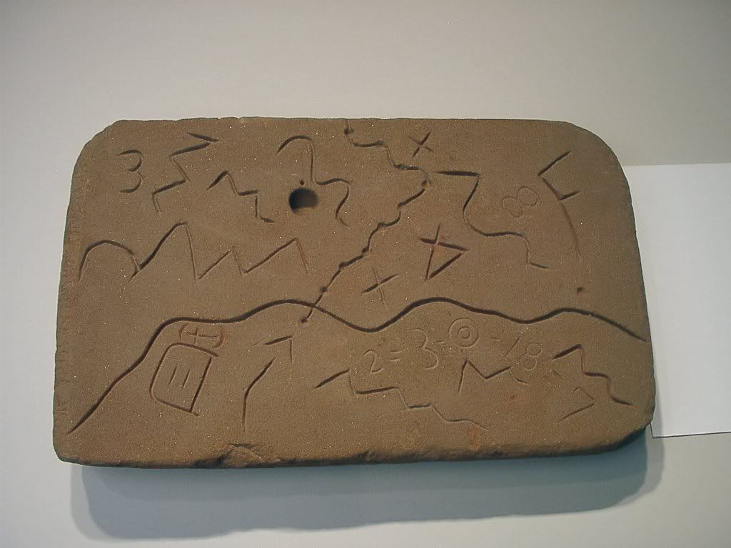

The photo which accompanied the DAI article.
And the description.
Notice anything?
Another photo.Taken while the stones were being held by law enforcement,pending disposition.
I think that this is when Bob Corbin first saw them.....as I recall.
Note the notch and the distance from the top of the notch to where the trail line begins.
Compare this with the stone at the museum.

I shot this view of the stone at the SSM last year,so I was aware of the notch visible at that time.
I was hoping that someone would reply with a better photo of the lower edge.Thus the leading question.
The black and white photo does seem to show a notch with sharper edges,though,but this could be a lighting issue as well.
Only one photo shows what appears to be a second large hole,however.It shows the notch as well.This is,of course the original Bumper Photo.
None of the photos have any "drill starter holes",or machine sanding marks visible.
Something else that I noticed in my photo was the proliferation of tiny white dots,but had thought that they were perhaps a reflection or spots on the glass case.
Evidently,and your photo makes this clear,they are on the stone itself.It might be interesting to find out if these white speck inclusions are common to cochino sandstone.
Another thing that bothers me,is the consistent shade of colour and grain structure with the two trail maps on display,vs what is visible in the Bumper Photo.Is this a characteristic of cochino sandstone?
Regards:Wayne

Golly, Ladies & Gentlemen: on your last picture, on your first post, just above the cross and crescent, on the right side, about 2 o'clock, on the outside of the curve, (top) it is very clear how it was made.
The same applies to the two slots on the lower left, you can clearly see the entry marks on both ends.
The work is obviously hand made.
However, on the other stones, the techniques are a bit different, leaving me to agree that they were made at different times, and possibly by different artists with different tools.
Not a single bit of evidence that 'dividers' were used, but on the contrary, evidence suggest something like a narrow bladed screwdriver and a hammer originally, then faced / bodied out with linear motions. No power tools.
