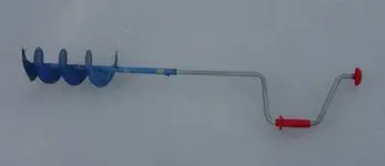

Started thinking, harbor freight sells one, why not put a tube around the auger to bring material up like an Archimedes screw
Oh that's right, they already have these
Drop the end on the gravel/rock bed and push/shovel rock towards the auger.

Drop the auger to your hole. Shovel material towards it. Toss big rocks aside like you would a suction dredge. As you get deeper, you lower the auger. And as you're getting deeper, shoveling is more pushing gravels down the sides of the hole.
Or you treat the auger like the suction nozzle. Swinging it back and forth, augering up material.

Auger dredges have been around awhile but used for sand. Rocks have a way of jamming them up.

It will never work. River gravels are a mix of sizes from sand to car sized boulders. An auger will jam up almost immediately when you start moving things any larger than sand. Even suction dredges won't work unless you have a man on the nozzles keeping large rocks away. You put hands near that and you will have a very nasty end to your mining days.
