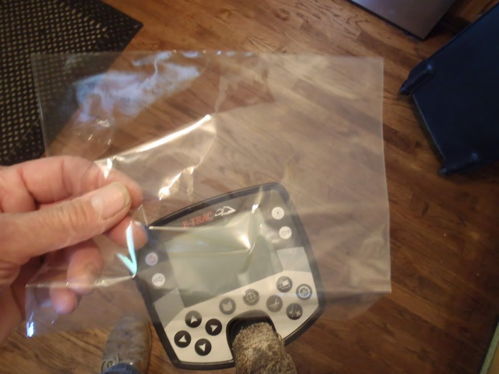

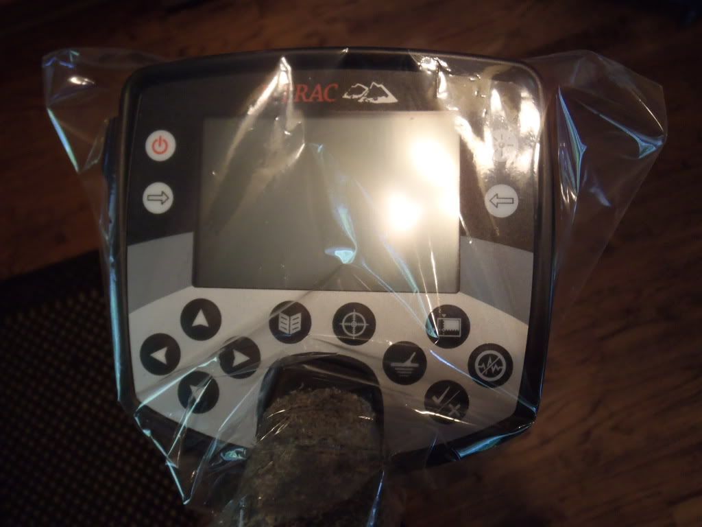

I got tired of not seeing the display on my machines. So I got an idea of using a heavy duty shrink wrap bag. They are cheap on ebay and I figured it was worth a try. I purchased several 8x12 bags. I saw where there are two types of materials used. There are PVC bags as well as POF bags. They say the POF bags are more durable and softer. Both types shrink 40%. I did some experiments on bag sizes and decided the 8 inch wide bags would be best. These bags come 12 inches long. I don't know which material is going to be best yet. But today my PVC bags came in. I saw where I needed to cut the bag 7 inches long. Then I pulled the bag down tight and taped both sides together under the bottom of the control box. Then I got my heat gun out and set it to 300 degrees F. I started on the back in the center making the front more tight from the back. Then I moved around the sides and top and finally the front. These bags shrink very fast and the machine didn't get hot. I took it out in the sun and the clarity is super. If you want you can cut your regular cover out where the screen is and have extra protection. I have already done this and it works fine. I'm sure this will work with the ctx3030 too. Heck it works on my xterra. You just have to cut a flap for the headphones and then run some clear tape around the cut out for some added strength. Some machines may require a different size bag? But I'm sure this will solve a lot of problems. One of the pictures shows me pealing the wrap off on my first try. You can use a hair dryer if you don't have a heat gun.
PS: I'll let you know how the POF bags work when I get them....
Update: I tried both types of bags and the PVC bags are way better. I've now had mine on for 5 months and is just now ready to be replaced. The PVC bags are very durable.

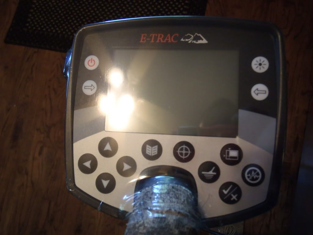

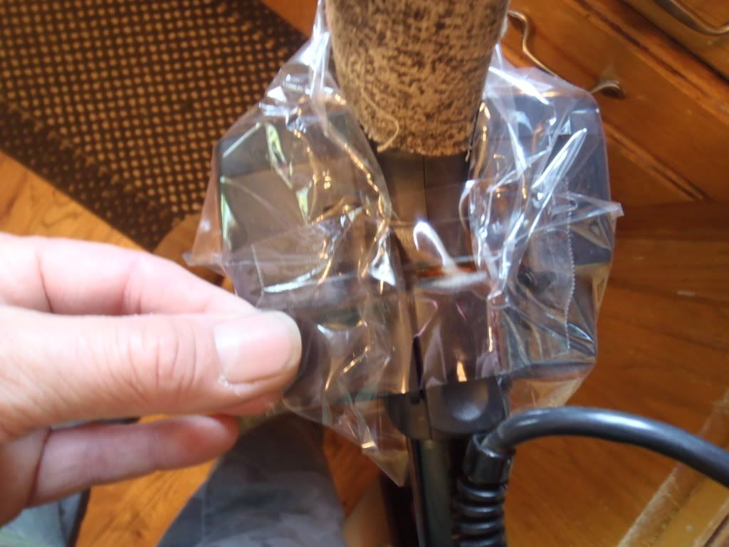

Khouse, very good idea so I tried it with the POF bags
The bags are so thin that when they are shrunk, ruptures appear in the skin. I have done 8 bags so far and have the same results. BTW, I am very careful not to overheat as I thought thats what I did on the first bag. After it cools its very tough and flexible but the ruptures in the skin have been in bad locations so the end results have been unusable. I finally got one to shrink without tears but it has wrinkles in the face so it doesn't look as nice as your job. Based on the difficulty of the thin POF bags I ordered, I wouldn't recommend them. Pic-1 shows the wrinkles, Pic-2 shows a small rupture that occurs when the bag is stretching taut.
My question to Khouse: Do the PVC bags have the same problem? I will order PVC if I can expect the same results as you have shown in your post.

I should have posted back about the bags. The POF bags suck. But the PVC bags rock! I've had my PVC bag on for 5 months. I'm about ready to change it out. It is very durable and stays clear. I'll make a video on the removal and installation of the bags.
