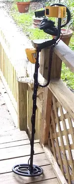

I Beach Hunt in Galveston, Texas and For Waist Deep Salt Water Surf I am using the Garrett Sea Hunter Mark II. It is a PI Machine. It is built solid, waterproof, sandproof and has worked every time that I wanted/needed it to. I bought a used one at my local Metal Detector Store for $575.00 (including tax) back in June 2009. If you Scuba Dive you can change out the rods and put the short scuba diving rod on it. Headphones are waterproof as well. If you do decide to do searching in the surf you will need to buy a Long Handled Stainless Steel Sand Scoop to make recovering items a whole lot easier. I will be honest with you and admit I do find a lot of pull tabs, bottle tops and junk metal along with the good items, which is OK with me. At least I am More Confident that I am not missing any buried metal items. The long handled sand scoop makes digging all signals alot easier.
I am Extremely Happy with my Sea Hunter.
My Girlfriend is using a Garrett Ace 250 to hunt the dry sand/towel line beach area.
Guy
