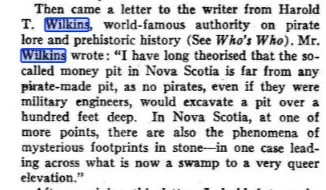

Wilkins wrote about the so-called money pit on Oak Island.

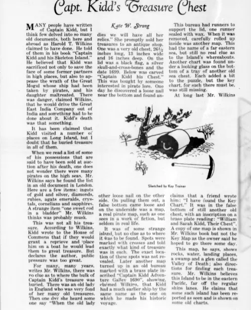

Long Island Forum 14 no. 4 (1951) published an article on the Kidd-Palmer maps by Kate W. Strong:

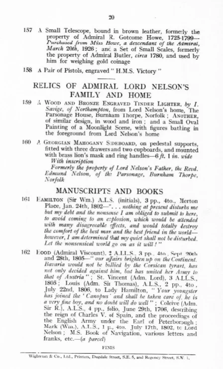

Christie's London Sales 1865-1939
7/21/1930 [Not listed but see below]
17 June 1930

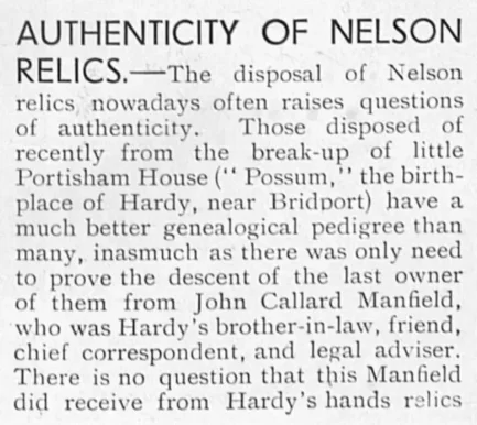

The Hampshire Telegraph and Post (25 June 1937) reported that Thomas Hardy's sextant (no. 134) was donated to HMS Victory in Portsmouth in 1937. The sextant now appears in the National Maritime Museum's collections.

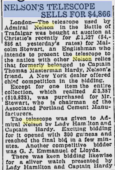

From The New York Times:
LONDON, Dec. 5.-The telescope used by Admiral Nelson in the Battle of Trafalgar was bought at auction at Christie's today for £1,527 [$4,886 at yesterday's rates] for Malcolm Stewart, an Englishman who intends to present the telescope to the nation with other Nelson relics that formerly belonged to Captain Thomas Masterman Hardy, Nelson's friend. A New York dealer offered chief competition in the bidding. Except for one item the entire collection, which realized £3,387 [$10,838], was purchased for Mr. Stewart, who is chairman of the Associated Portland Cement Manufacturers. The telescope was given to Admiral Nelson by Lady Hamilton and Captain Hardy. Exciting bidding for it opened with 300 guineas and reached the final bid in a few minutes. Another competitive bidder was G. J. Emmanuel of Lloyds.

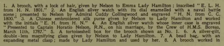

Photo of these items:

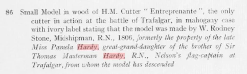

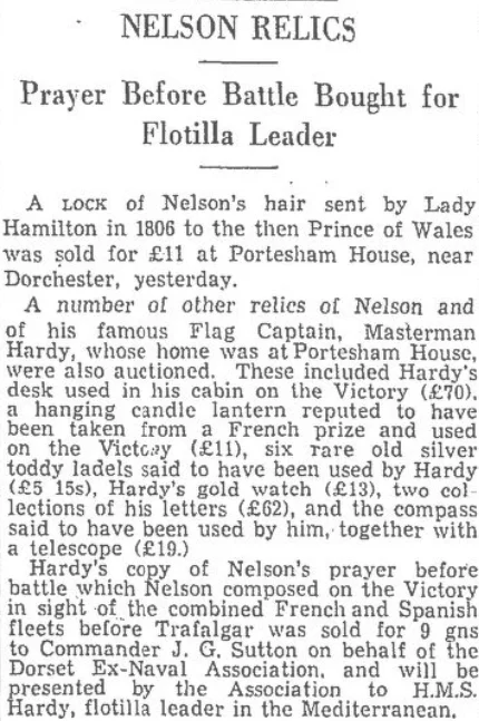

The sale of this item (a small model) was mentioned in The Western Morning News and Daily Gazette (16 June 1936):
The small model in wood of HM Entreprenante, the only cutter in action at the Battle of Trafalgar, has descended from Sir Thomas Masterman Hardy, Nelson's flag captain at Trafalgar. It became the property of Sir Thoma's brother, and reached his great-grand-daughter, the late Miss Pamela Hardy.
Note that this item was purchased at the auction at Christie's on 17 June 1930 (no. 141) and then sold as Sotherby's six years later. It is possible that Mrs. Nevill Jackson who was the vendor at the latter had purchased the small model from Christie's. She actually sold around a dozen more spurious Lord Nelson items; some of those were probably bought from the earlier Christie's auction as well.

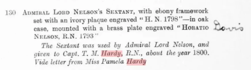

The following items were accompanied with (fabricated) letters by Pamela Hardy:
17 June 1930
No. 128, Lord Nelson's Watch in silver case (by Joshua Trewinnard, Strand London)
No. 130, Admiral Lord Nelson's sextant.

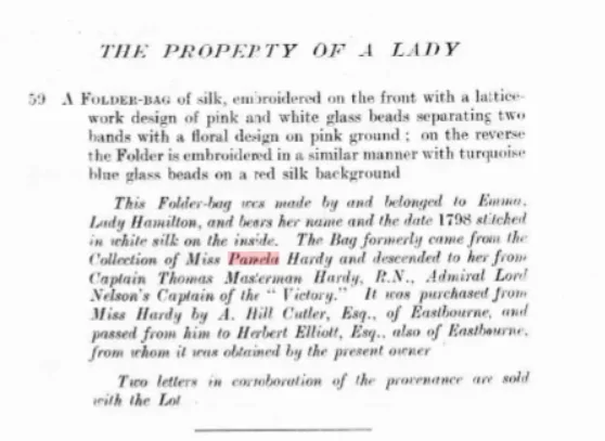

Correction:
Above, I managed to find the auction brochure (catalogue) for that date (28 February 1933). Matthew Sherriff Gosling did not own or sell any of the items of the (fake) Pamela Hardy provenance; his items were sold at the same auction when Hardy items were sold (pure coincidence) but they were clearly separately listed and should not be confused with Hardy's. In other words, none of the Hardy items were sold by Gosling. Who were the vendors of the Hardy items? The vendor was anonymous for most of the Christie's auctions (although we know it was a male, "Gentleman") excluding one auction held on 10 May 1932, which openly identified the seller as Hubert Palmer. It seems highly probable that it was Palmer who was the anonymous "Gentleman" since he sold a large amount of similar items to the others with the same fake provenance. I previously suspected the anonymous seller was Arthur Cutler but it rather appears Cutler sold Palmer the items and Palmer then sold them at the auctions. Cutler was not the vendor but had supplied the items to Palmer. This is supported by the fact one of the items sold on 28 February 1933 came with a letter stating that it was Cutler who purchased it from Pamela Hardy but he had passed it on; the catalogue also noted: "It was purchased from Miss Hardy by A. Hill Cutler and passed from him to Herbert Elliot, from whom it was obtained by the present owner." We also know it was Cutler who sold the Hardy Chest to Palmer and that he sold many other items to Palmer based on letters Palmer wrote to Wilkins (published by Gjb).
The item sold on 28 February 1933 accompanied with two letters from Arthur Hill Cutler and Herbert Elliot was not owned by Hubert Palmer but an anonymous woman - who was the vendor. This was the only item with a (fake) Pamela Hardy provenance owned and sold by a woman at the auction on 28 February 1933. This is made clear for the item no. 59 in the auction catalogue, "The Property of a Lady" (item nos. 44-58 were instead sold by an anonymous "gentleman" [who was most probably Hubert Palmer]).
You can access these letters and the item from the collections at the National Maritime Museum.
I have photographic copies (and digital scans) of the letters but do not have copyright permission to post them.
Nevertheless, I can quote them:

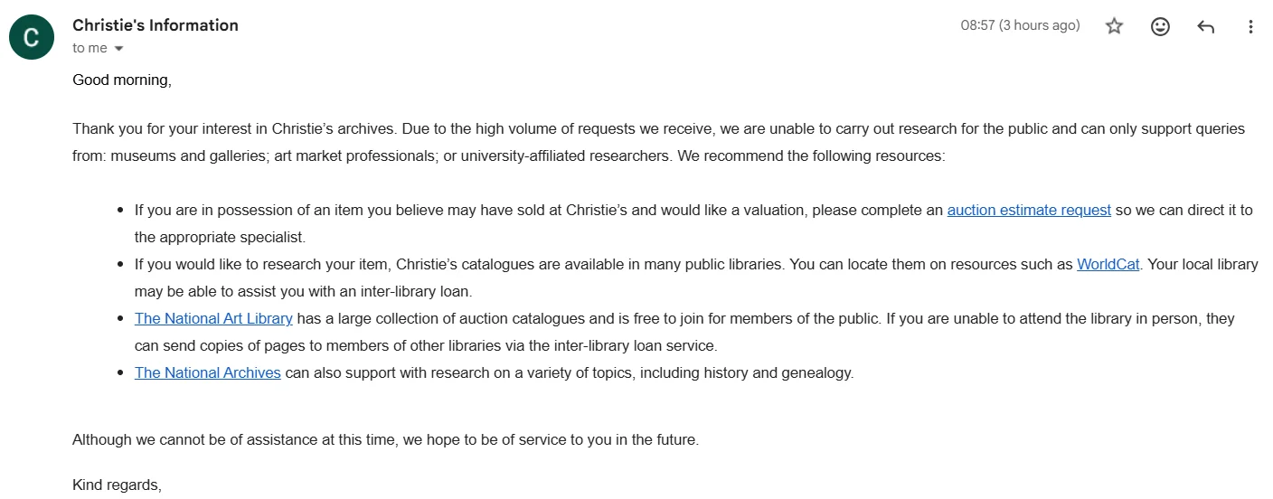

I will ask Christie's if they can provide any more information.
Unfortunately, they cannot help. Christie's are no longer accepting requests from the public and denied me access to their archives.
Their policy changed in 2021:
I presume Gjb, obtained the information he posted above before 2021.
