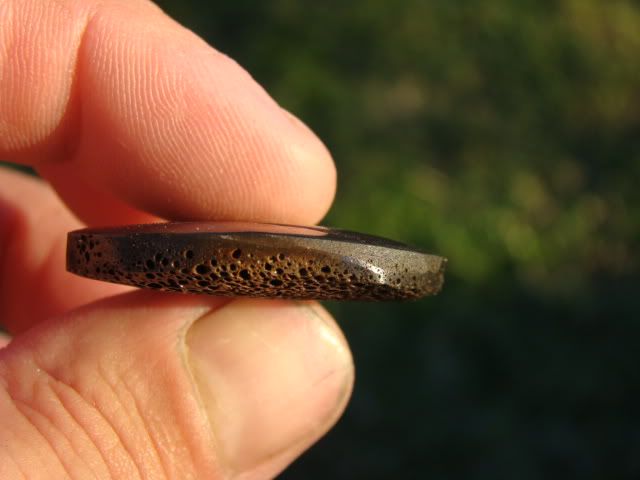

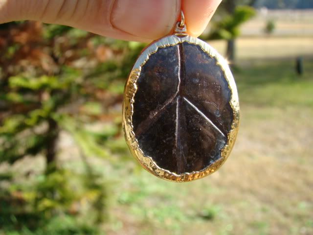

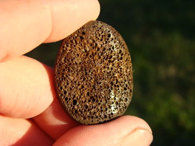

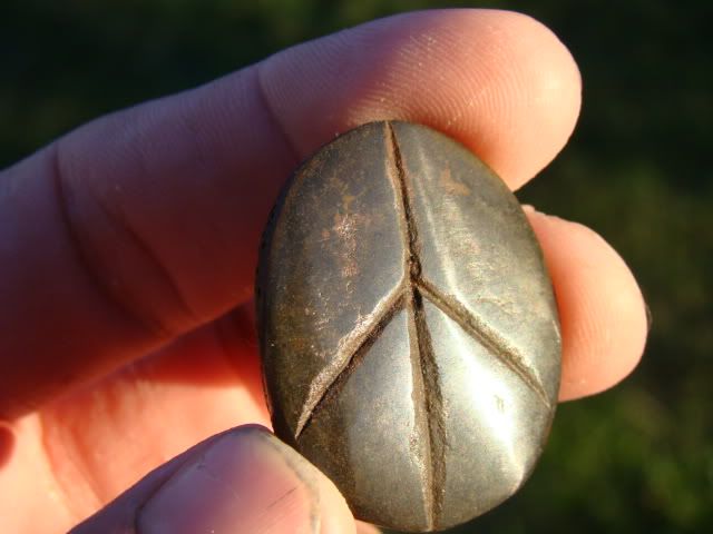

I cant tell you how many times I will start cabbing a stone and then 3 wheels into it I dont like it anymore. I`ll just toss it aside into a box for those and grab something elsde and start a new one, if I dont like that then in it goes. All these are domed at this time, so I do tumble those and thats what I usualy give out to the kids at the schools when I do the Great American Teach In each year. I do that on Florida history and artifacts but kids love rocks.
Here`s 1 I made for my daughter, its a piece of fossilized turtle bone I found diving in the summer, its the underside back piece and has these lines in it naturally. I just ground it down to this shape to make a peace sign, all the kids want 1 now.
