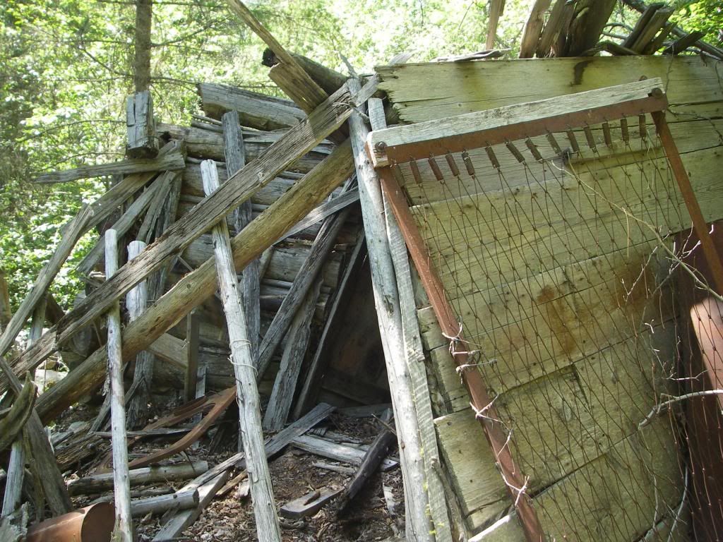

In California that is a nice 'fixer-upper'! Somebody went to a lot of trouble to build that place and haul in a bed frame. Either they just loved being "back in there" or they had a good reason for all that work. And thank you for the pictures and the ramble though it really was not rambling it was sharing more of your hard won knowledge...................63bkpkr
That bedspring has had a bunch of repairs if you look closely, and it's had at least one modification. I'll bet it was a doozy to pack in to where it is now. That's some awful tough country back in there. No roads at all. But, I guess if you were a miner that was going to be living there, it must have been worth the pack trip through the timber to get it in.
The cast iron stove must have been a real charmer to get in there too. I've got a picture of the rest of it somewhere too. Maybe they used pack mules that had some good tree smarts so they wouldn't get hung up in the timber on the trip in with that stove.
All the best, and thanks for dropping in my friend,
Lanny
