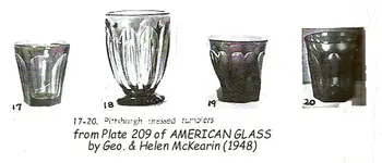

American pressed glass has been around since the 1820s. I'm certain you can Google information. Here are some illustrations from Albert Christian Revi's 1970 book, AMERICAN PRESSED GLASS AND FIGURE BOTTLES.

I don't think this is pressed-glass, but a cheaper and more pedestrian quality and quickly produced item. Harry is right that the rim/lip isn't tooled per se, but it seems pretty clear that the rim has a thicker fire-polished bead (not sure if pressed glass routinely got this treatment), which would have necessitated an efficient way to hold the open end in the furnace (pontil). I'm thinking this piece was blown like a bottle into a 2-piece or 3-piece hinged cup mold or something like it, with the excess sheared off and the rim subsequently fire-polished.
I agree that the ring around the perimeter is suspicious, but the apparent iron-pontil mark (minus the iron oxide) carries much more weight in my estimation.

This analysis seems to depend on the irregular spot on the bottom of the tumbler; but, there is no evidence that this is a pontil scar. In fact, the symmetry of the piece bespeaks "pressed glass" rather than "hand blown glass."

So your right, pressed glass had no trimming or fire polishing. If thats a pontil mark then this was blown into a mould, pontiled and the lip either trimmed and opened with minimal tooling from the jacks or hot popped and fire polished.

Yeah, definitely not hand-blown and not a tooled lip. I'm on the pressed or machine team. It's only that outer line that confuses me.
I think that although it was not totally necessary to pontil the thing, maybe something happened during the process and they had to grab it while it was hot and couldn't simply use their hands.
I wonder: are there other pressed glass pieces that have either a pontil mark or that strange outer line?
