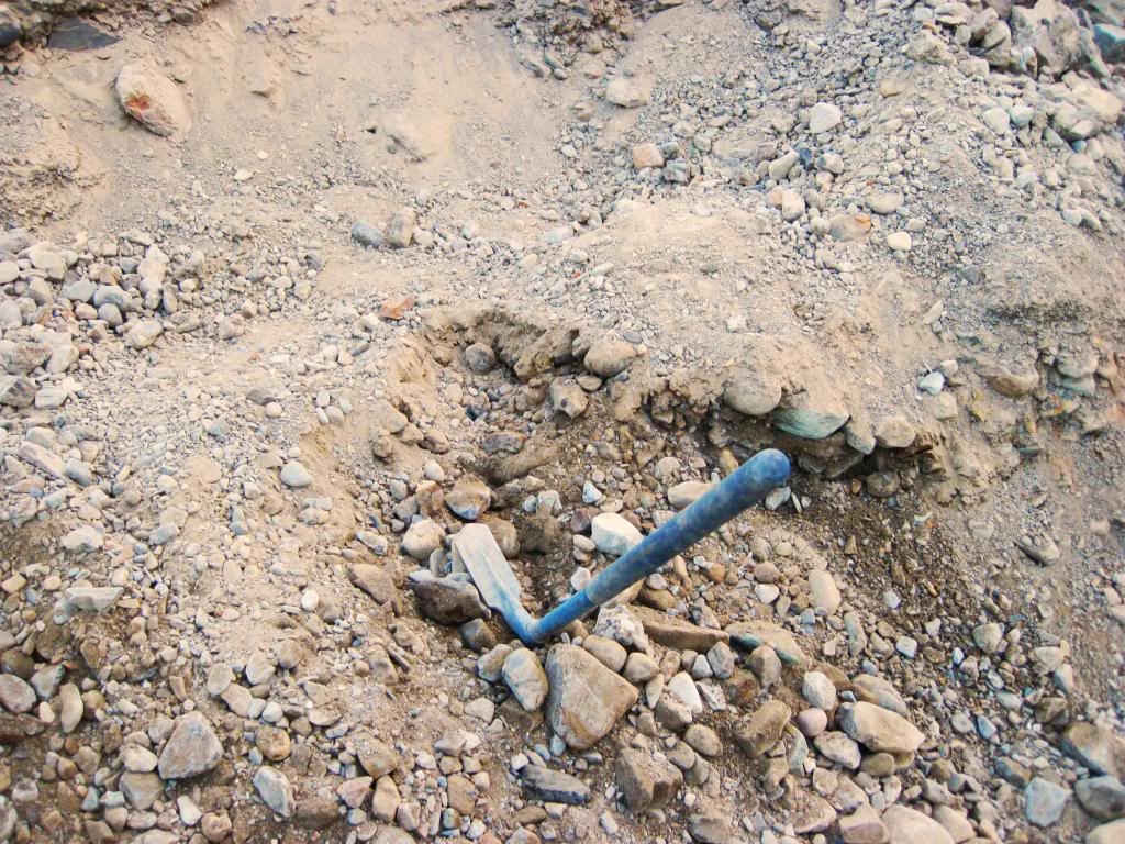

Rake your way to the nuggets:
http://
I remember once there was a spot I'd looked at several times. It was situated in a place the Oldtimers had worked very hard in the 1800's and then again in the 1930's. Speaking of the '30's, a lot of people probably know that there were more people mining for gold then in some of the goldfields than there were in the 1800's, that's how tough things were. But people could scratch out enough gold to feed their families when there just weren't the social safety nets there are now.
As I've prospected for quite a while, I've gained an appreciation for how hard it is to recover gold, the intensive physical labor involved in the process, and it's given me a whole lot of respect for those early miners. I recently visited a site where a very small drift was uncovered by modern day placer miners. The height of the drift is only a couple of feet, and the drift miners were of course following the contours of the bedrock up from the river under a solid overburden of boulder clay while lying in water doing their work! And, that water is never, ever warm.
It boggles my mind, the intense physical work required to work around boulders underground in such a small space, to drag rocks and muck out of that narrow drift. But, in the 1800's or the 1930's, they were working to provide for their families, and oftentimes because of depressed economic times, those Sourdoughs had no other options. So, working in that cramped drift must have been worth it as they went back in a very long way under that sketchy overburden chasing the nuggets.
As usual, I've drifted from my story, but I'll get back to it by saying that after I'd studied the spot a few times, I decided to give it a try as the amount of workings suggested there must have been some good gold present.
Well, to get to where I needed to be, I had to lug my equipment down a very steep incline, and as I don't like to make more than one trip while navigating such slopes, of course I rigged all of my equipment around my body (thank heavens for bungee madness) to make it all in one trip. Sometimes it works, and other times it results in spectacular failure. Nevertheless, this time, I made it to the bottom of the slope without any traumatic reversals.
I'd lugged a heavy bar down with me for nosing boulders, and I'd packed a manure fork modified for raking cobbles. I'd used that fork before to good effect raking down old hand-stacks, then detecting nuggets still trapped in the bedrock that hadn't been molested since the 1800's. That's one of the possible good effects of raking off all of those old cobbles, the bedrock underneath might yield something to modern electronics that the Oldtimers had no chance to recover.
I headed for the spot I'd selected, but when I got there, I realized that it had never been mined before. All of the indicators showed rock, clay, and gravel that had never been moved, ancient river run still in place. I was a bit puzzled at first, but as I investigated more, I realized that this material had been left because it was likely a spot where they'd run a sluice box through, and the dirt had supported the sluice end that had shot the material over a cliff to discharge its contents into the river, not something that would fly today. Nope, that's for sure!
So, I got busy with the rock rake and started to pull out cobbles, smaller river run, and clay. I'd stop to detect the raked material from time to time, but all I got were lots of square nails that were running in predictable lines, nails left over from where ancient wood had rotted back into the earth, leaving only the rusted nails that held together the sides of the sluice. That was a frustrating time with so many bad targets, but eventually I'd removed a pretty good chunk of ground, and I noticed with some excitement that I'd hit bedrock.

Now, whenever I hit virgin bedrock, I get a bit worked up as the chance for finding gold with the detector is much greater than in areas that have been exposed and hammered endlessly by every Tom, Dick, and Harry with a nugget machine.
So, I fired up the detector once more, but this time I used it to scan the bedrock. Almost instantly I got a loud "whack" of a signal. Naturally I assumed it was another square nail (the detector being a pulse machine, not an excellent discriminating VLF). Well, imagine my surprise when I moved some clay around and saw a sassy nugget trapped in a pocket in that bedrock! Talk about blood pumping to my brain!! It was a three gram beauty of a piece, but flatter than a Kansas corn field.
Naturally, I started to move rocks like an episode off of some fantasy show like Rakes Gone Wild or something. I really let the dirt fly. I kept checking the top cover of dirt and rocks with the detector, but all I collected from the overburden were enough nails to build my own sluice. However, when I hit the bedrock again on another cleared spot, more nuggets, smaller this time, between one and a half to two grams, and still flat and hammered, but what little beauties they were. Those pieces of gold actually seemed glad to see the sun again after so much time underground.
Now, I don't know about you, but when the dirt's paying, it's got to fly. So, I cleared another spot, and once again, there were nuggets right down in the bedrock, but this time I had to use the hammer and chisel I always pack when I know there's a chance of working bedrock. The last two nuggets were trapped in a crevice with a whack of black sand, but the hammer and chisel rooted them out, and they were both slightly under a gram, and yes, flatter than a pancake made without baking soda.
To make the rock rake, we took a multi-tined manure fork, heated it with a torch, bent the tines to 90 degrees, cooled the metal to keep a temper in the steel, then cut off the sharp ends. One tough rock-raking fork resulted! It has a nice long handle to produce a long, easy sweep as well. Plus, it saves your back from all of that bending, and chucking, bending and chucking that you get to do without a fork, never mind the fact that the fork method is way, way faster.
Nonetheless, the time came when I hit a barren spot, and by then, I'd moved enough rock in the hot summer sun to make me remember that I still had to climb a mountainside, while packing all of my gear, to get back to my truck. Common sense overwhelmed the gold fever and cooled the blood, and I made my way out.
http://
Did I get all of the gold? Heck no, but it's like a little bank that I can visit again and again, hoping to make a withdrawal, knowing that there's a good chance that there'll still be something on deposit in that virgin branch of Mother Nature's timeless treasure vault.
