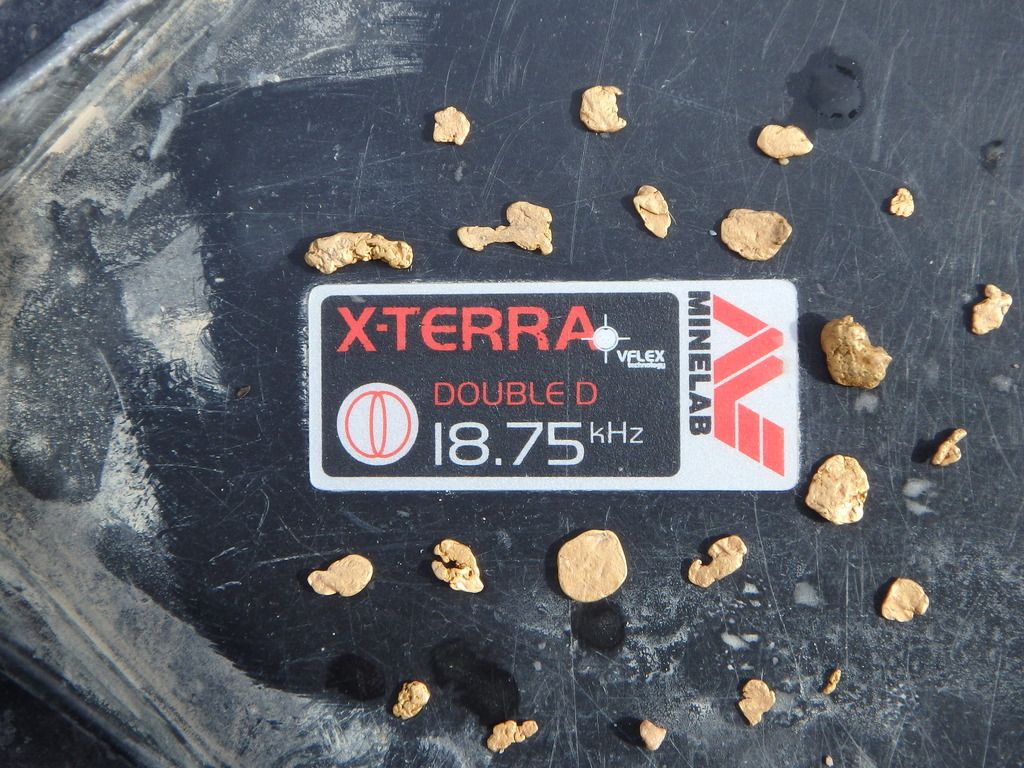

Tried some different tactics this weekend and sure had fun, got gold too!
Used the Minelab 705 X-Terra, and the little Falcon as I worked on exposed bedrock.
I'll post some pictures and write a bit when I get the chance.

Cool ! :thumbsup: How the X-Terra 705 performed ? Sure need to hear your experience with it .
The more I use it, the more impressed I am with it for detecting gold, smaller gold especially. Of course, it finds the bigger stuff too, but it's a very sensitive machine. It won't go as deep as my 5000, but it's very light and easy to swing all day long.
I like it. Minelab put a lot more in that little machine's gold circuitry than they had to, and the coin hunting technology works very well, and the discrimination does a great job too.
As it's a VLF, it's not designed to tackle super-hot ground, but I used it on some moderately hot bedrock this past weekend, and it found the gold . . .
