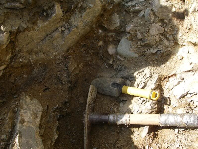

Bedrock Tips:
How many of you have had the chance to work virgin bedrock?
By virgin, I mean that the bedrock has been exposed by modern mining. In other words, the bedrock has not seen the light of day since the gold was originally deposited on it or in it eons ago. Moreover, a chance like this is a rather rare opportunity because it requires prior connections with the miners in order to have access to this bedrock. After all, it's very expensive to remove the stubborn overburden to expose the mother rock. Furthermore, some miners are very sensitive about allowing anyone access to their virgin bedrock for any reason at all, if ever. It's a bit of a loaded request, even if you already have a personal relationship with the miners.
So, if there's no prior relationship, the chances are slim to none for access, and even if you do have a relationship, the answer could still be no. You have to be ready for any eventuality.
However, if and when you do get the opportunity to work such bedrock, there's a few things that will help your chances in finding any residual gold left behind from the mining activity.
First and foremost, ask questions.
Find out where the heaviest run of gold was in the pit. For example, find out it the deposit was heavier in a dip in the bedrock, on the start of a rise, on a shelf, at the bottom of a long drop, etc., and find out if there were certain colors in the dirt that indicated better pay: oranges, reds, grays, purples, blacks, etc.
With the answers to a few questions like these, you can improve your odds of checking the most-likely places in a large excavation. For instance, you'll find areas that were barren by asking like questions (areas of loose wash, etc.), and you'll locate areas that were hot spots by doing the same.
When it comes to detecting, you'll need to pay careful attention to the answers to your questions plus you'll need to pay close attention to what the detector is telling you about the temperature of the rock you're hunting. For example, if race into the pit and start swinging like a madman to cover as much ground as possible in the shortest time, you'll be doing a disservice to yourself. Why? Virgin bedrock demands respect, and it demands a slow approach while listening to the ground minerals and scrubbing the surface to obtain every cm of advantage while listening carefully to the tiniest alterations in the threshold. As well, by paying close attention to the mineralization, you will learn which coils will be most beneficial, including which size of coil to utilize. (A variety of sizes may be necessary to do a proper job, and in extreme ground, the wrong coil type will be an extreme waste of time.)
As to the bedrock itself, you may wish to employ a tiny detector like the Falcon to find streaks and runs of fine gold that will elude your bigger detector's coils. It's surprising how much fine gold can be left on bedrock or caught in cracks. I had my eyes opened wide several summers ago to just how much gold gets left behind and just how much fun it is to use a tiny detector to chase pockets of fine gold!
As for non-electronic sniping, it's very important to study the rock carefully. Often when working virgin bedrock, clay is a common occurrence. And, that clay is a great hider and or robber of gold. Moreover, look at what's riding within the clay. Are there little stones of various sorts? Is it just slick clay (no inclusions)?As well, be meticulous about examining the surface of the bedrock. Sometimes what looks like perfectly level bedrock with a solid surface may have cracks and crevices perfectly camouflaged by the minerals that are running within the clay, minerals that match perfectly in color the host bedrock. Use a variety of tools to scrape and scratch at the surface. I've been stunned while sniping non-electronically more than once by uncovering small cracks and crevices in this manner, ones that held a surprising amount of good gold.
As well, if the bedrock is dry, get a good sledge hammer and hit the bedrock to see if any puffs of dust arise like little fountains of fine particles. This signals a crack or crevice. One of the wonders of bedrock is that a crack or crevice may be snapped shut tightly, but widen below its mouth significantly. I remember the first time I found one of these: it had a pocket of small nuggets in it, and the nuggets were far too big to have found their way into the crevice opening. There are lots of theories as to how this happens, but the important thing to remember is that it does happen. I've also found larger nuggets this way as well when sniping without electronic backup.
What tools help with this process? For inexpensive alternatives, a blade screwdriver bent at a 90 degree angle; a wire brush; a stiff bristle brush; an awl; a pocket knife; a small metal gardening shovel; a variety of household spoons (teaspoon size to tablespoon--be sure to have sturdy ones that won't bend easily); a small sledge and a couple of cold chisels for widening cracks and crevices; if water is present, a suction gun of some kind; etc.
With virgin bedrock, you will have the chance of a lifetime to find gold in a place that no one else has ever looked, so take the time to do a thorough job, and the reward can be great. On a connected note, I've come behind others that have worked such places in a hurry and found some beautiful nuggets (larger than anything they found) because they tore across the bedrock in a mad rush to cover the entire area. The sad truth is that if they'd have slowed down and paid that virgin bedrock the respect it deserved, they would have found the bigger gold instead of me.

Here's an oldie, but goodie.
When you're sniping underwater (or dredging, or digging your hole to China in a stream-bed, modern or ancient), and all of a sudden you start to see chunks of ironstone or magnetite the size of golfballs, or you start to see big nails, spikes, chunks of cast iron, etc., you're in a serious drop zone.
Most of the time I've noticed these on inside bends, but in straight canyons, these drop-zone deposits will be found behind ledges, large boulders, behind hidden, underwater obstructions, etc.
However, these items, even though they are heavy, may be to one side or the other of the gold, and sometimes, they're even above the gold and you've got to go down a bit more to hit the gold, just as you'd have to check carefully to the left or the right of the aforementioned line of heavies to locate the best gold.
The good news is that the water dropped the large variety of heavies I've mentioned, and because of that, it generated a great chance that the gold dropped too. The mystery you might be faced with is to have to look a bit harder to actually find the paying line of gold (to the right, to the left, just a bit deeper . . .).
Don't get me wrong, I've found iron bars before with nuggets stuck to the oxidization encrusting the bars! I've also dredged spots where golfball sized magnetite sat in the middle of the visible gold too, but other times, it takes a bit more looking to hit the sweet spot. (And of course, sometimes there's only heavies and no gold, depending on what the river was carrying when the heavies dropped.)
All the best,
Lanny
